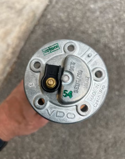

I think, the fuel sender and gauge may not be compatible. Older boats often have sensors with different ohm ranges. Common examples include: European/VDO: approx. 10–180/190 ohms; American: approx. 240–33 ohms. If the sensor and gauge are not compatible, the gauge will display completely incorrect readings - such as “empty” even though there is still plenty of fuel left.
It’s also possible that the fuel sender is stuck or clogged.
Or the tank may have actually been replaced at some point with a much smaller one. I’ve seen this happen myself: someone removed his large tank (400 liters) and planned to install a two-tank system (2 × 150 liters), which he never actually implemented, and ended up with one 150-liter tank.
Either way, I’d recommend removing the fuel sender and taking a look. There’s a picture of it in the attachment. It should be mounted to the tank (at the top) with five screws.

Thank you for the help! I will have a look at the fuel sender and try to figure out what the problem is.
