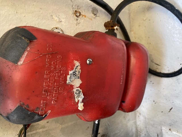

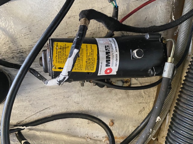

Another question. I have these two. I believe they are pumps for the trim.
What kind of maintenance are needed on them?

Hi
Check the oil level and that three is no water i oil.
Red pump is for boat leveler = trim tabs
Oil = trim tab hydraulic oil biodegradable or ATF
Black pump is for the sterndrive powertrim.
Check color RED= ATF Brown Motor oil works with both but use the same type of oil when refilling ATF=ATF, Motor oil=Motor oil. Do not mix oils.

Next question is then where do I check/fill the oil on these
On the red pump, I see a little hole close to the bottom on the left side. That might be it.
On the black pump, I cannot see any area for checking the oil level
