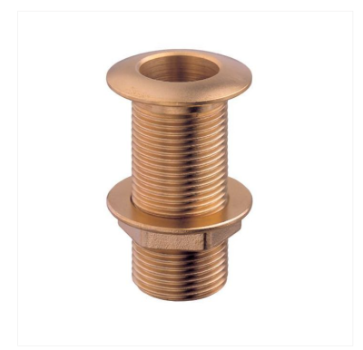

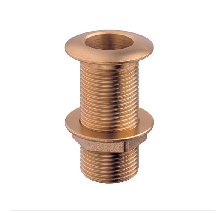

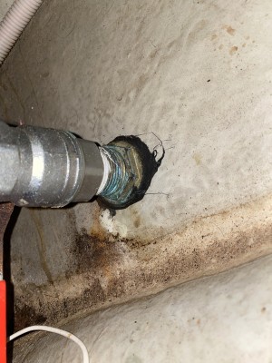

I have 3 fittings in my Fjord 24 that I plan to change this winter. Believe its the originals.
As I understand, its recommended to use a composite or bronze fitting, like this one:
https://www.boatlab.se/guidi-bordgenomf ... e_products
But how easy is it to remove the old fitting and install a new one? Is this a "do it yourself task", or should I call a pro?
Any guide or tips would be appreciated.

Hei Thomas,
If you have an angle grinder and a large spanner you can do it yourself and an assistant will make it easier.
Here is a Swedish video guide: https://www.praktisktbatagande.se/livet ... enomforing

As they say in the video, just tighten the nut quite light with your fingers first and when the sealer is hardened you can tighten with a spanner.

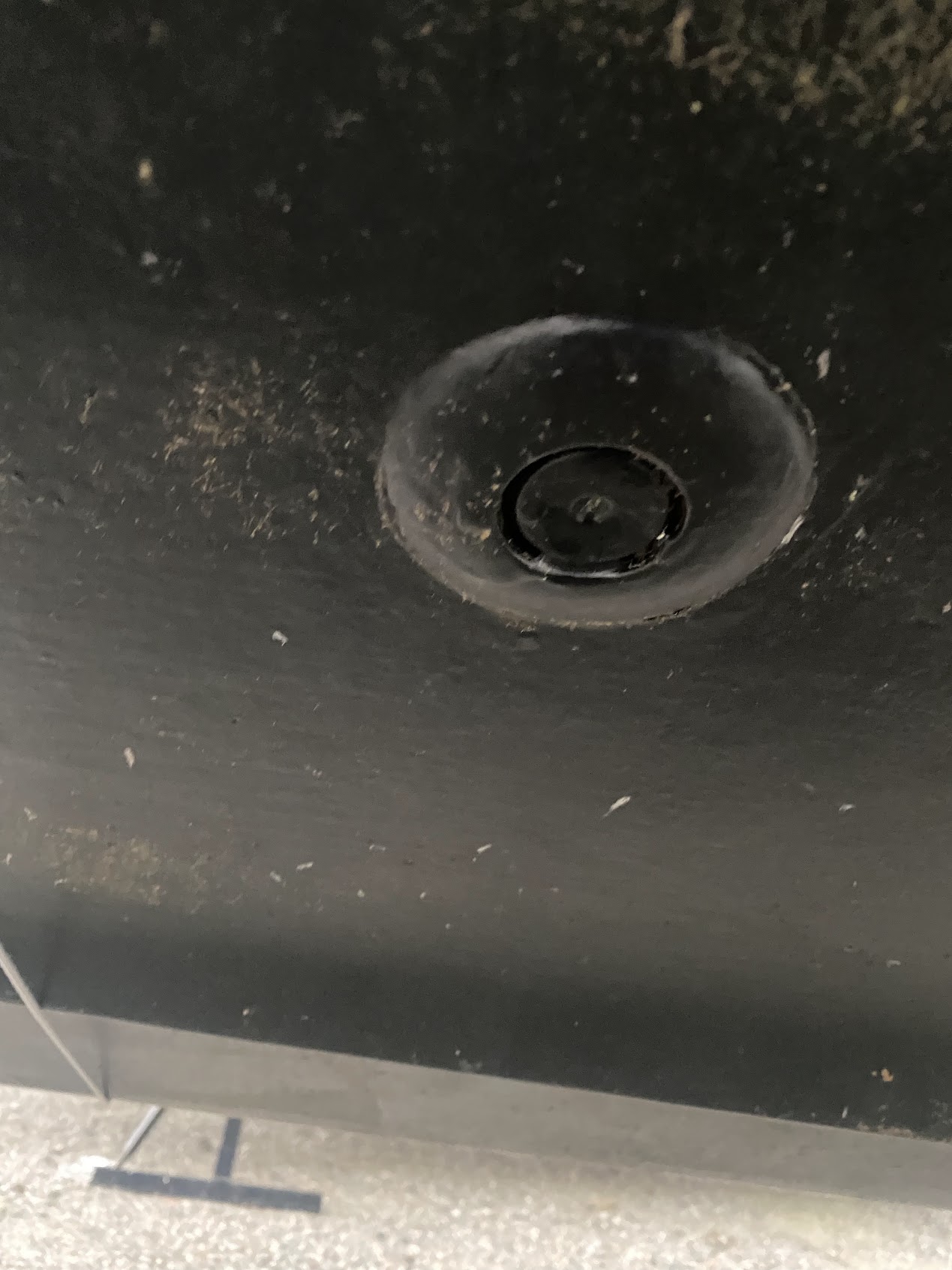

I also have one of these in my boat. Do you know what it is?
Makro
Inlägg: 325
Blev medlem: 22 jul 2018, 23:16
Ort: Hönö
Re: Bordgenomföring
Inlägg av Makro »
Yes it's a transducer for the echo sounder or at least a bracket for the transducer with a "dummy"
It may have been a sensor for a speedometer as well.
